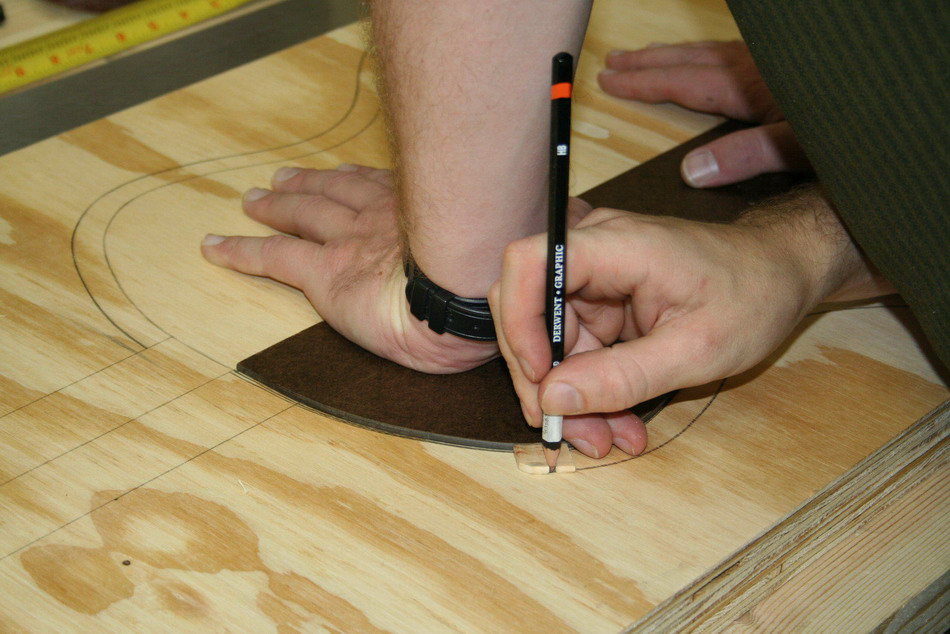

OK so I made my first jig ever... if you can call it a jig. Go ahead and laugh... I can't help it I'm excited.
I needed a way to draw out my workboard 1/2 and inch larger then my template. So I cut some paint paddle down and made a hole for my pencil at 1/2 inch!

Good idea, sometimes it's the simple little tricks and discoveries that make this craft fun. Another way is to use a washer and roll it along the edge.

I`m not trying to rain on your picnic, but a flat washer might work a little better and more accurately.
Lay the washer against the template, pencil inside the hole, and roll the washer along the template. Make sense?
You`ll lose the accuracy of the inside curve when using a squared edge as you`ve shown.

[QUOTE=Cocephus] I`m not trying to rain on your picnic, but a flat washer might work a little better and more accurately.
Just trying to help, dude.
Coe[/QUOTE]
Great Idea! Thanks.

I dont think that its too "critical" that the 1/2" dimension remains deadly accurate for the outside dimension of a workboard,
.....or does it?
Ive seen layout tools with just such "technology" employed - youll be on to more advanced jigtech in no time!

I use the flat washer like Coe.....just roll it around
